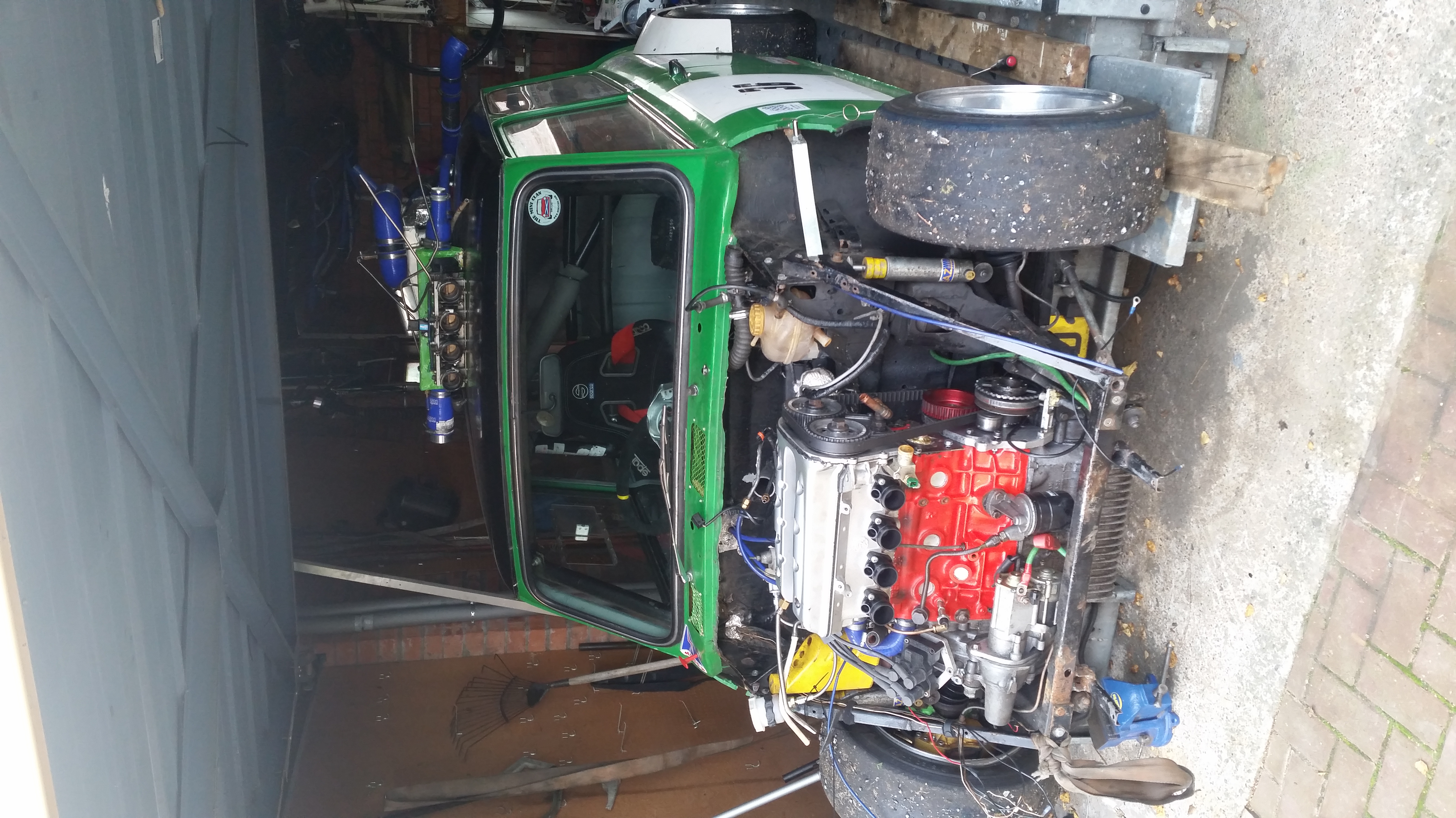

Not sure about the bottom arms, it's all in bits now. You can see in this picture how bad the lack of damper travel, driveshaft and top arm angles are though...
I'm currently running solid subframe mounts and solid engine mounts. Don't really want to raise the engine if I can avoid it but I guess there is a sweetspot between centre of gravity and suspension Geo...

Yeah, it's hard to tell on that photo, but keeping the bottom arm horizontal at rest is as sensibly low as you want to go. So that might be a tweak to start with.
It looks like you need shorted dampers. I had some made to my specific length, iirc around 25mm shorter than the 'lowered' dampers that are available for minis.
I wouldn't raise the engine, keep that weight as low as possible. Nick only need to do it as he's on 10" wheels and planning to drive over speed humps!
The main issue is that we use 13" wheels on 20" slicks meaning it's on stilts to start with.
