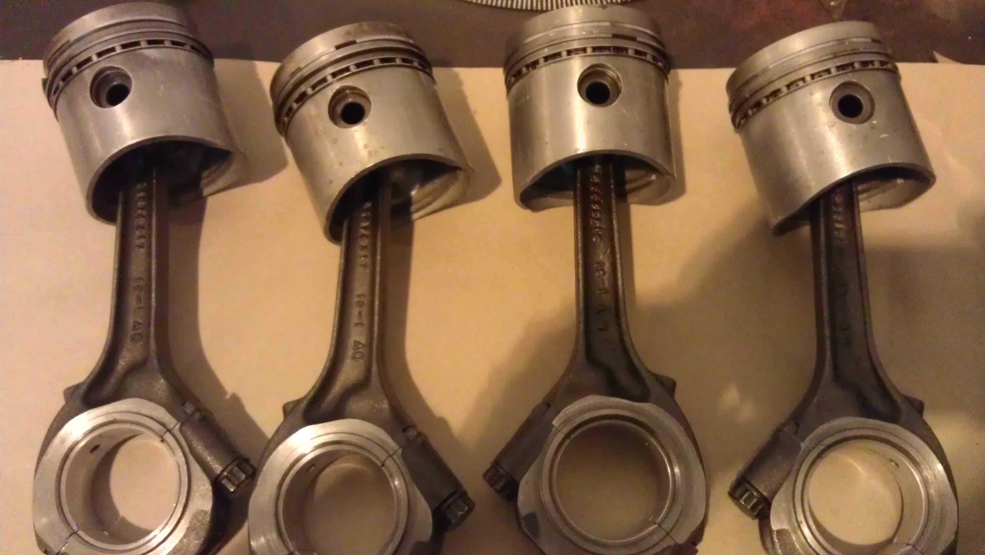

I wanted to replace the piston rings as a precaution, all I know is that the pistons are Powermax +30 offset pin pistons (quoting from previous owners description.) I've attached a photo. On the tops it says: B.030 - H and underneath RP 54.
Wondering if anyone could help me locate any rings?

If the rings are the right depth/thickness, then you could try to fit a set of +0.040" rings but you will need to carefully file the ends to get the right gap. Measure the ring slots. I can check against a set of rings in my parts bin.
However, if you go for new pistons, you could get some dished 20773s that would bring the compression ratio down to what you need.
That oil pump looks like a standard one to me. It's quite easy to modify a 1275 pump to fit and drill the block for the other bolt location. I bought one from Paul Hickey Racing, Paul H on here.
Baulk rings can often be reused. A lot of the copies are worse. How bad are the existing ones?

Those pistons are most likely Powermax 20950s and would be better then the 20773s in a boosted application.
You could get some +0.040" rings to fit, but it depends on the slot depth. Vizard lists the 20950 as having a 0.157" oil control ring, but the latest equivalent in my parts bin has a 0.125" oil slot.
Have a measure of the slots.
However, if you use the flat tops you still have the CR problem.
Went down to the unit and measured the slots last night, weren't the best verniers but we measured the top ring as 1.73mm next 2mm and oil control ring as 4mm. The oil control ring would work out at 0.157" then.
The guy whose helping me build said the rings that are already in should be fine as there hardly used, and the bore's are also fine. So i was thinking to bring the CR down i could possibly take some out of the pistons? and some out the chambers.
998 t2 ongoing project.
Top and second ring slots should be 1.6mm at most.
