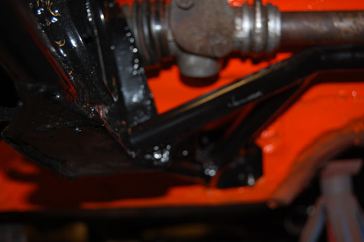

Ive been busy, heres a peek.
lower subframe brace?
I used to have lower brace on my mk1 gti sharpened up the handling no end, never thought about it on the mini
10022 Posts
Mike you teaser!
looks a bit transplantesque to me....
Show em your meat Mike
Is the large chunk of flat steel heaver than all the tube you replaced it with?
What about triangulation for the towers?
