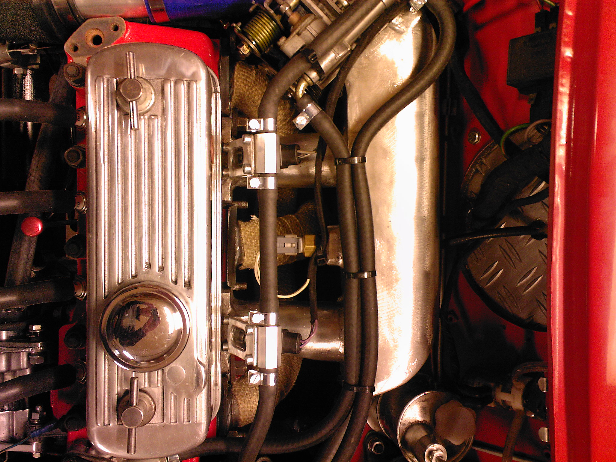

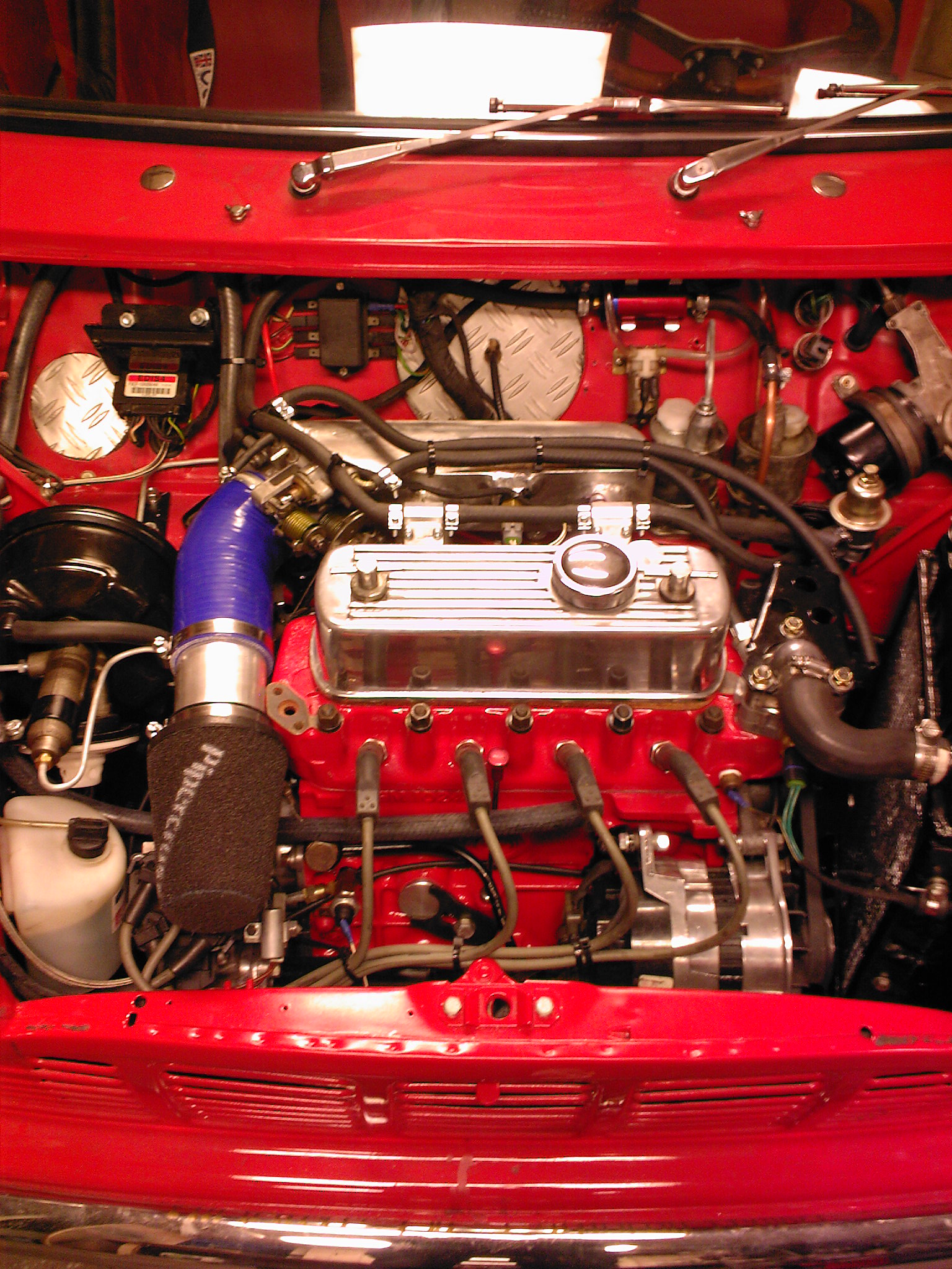

I just finished building my port injected inlet manifold and I am ready to connect my MSII extra with the latest sequential code to the engine. Everything has beens tested and seems to work.
First some engine specs:
1380CC A-Plus, Kent md 286sp cam, 1.5 full roller rockers, belt driven cam, stage 3 head with Rimflow in and exhaust valves, omega cast pistons, Ultru light flywheel/back plate, MED 36-1 crank wheel, carbon fibre pushrods and Isky followers. 50mm 'Nissan' throttle body. Delphi injectors 42lb/hour with regulated fuel supply (between 2.5 and 4 bar).
I am new to injection but read about everything I could find on this subject on the internet. I added a picture of the engine with the homemade inlet manifold. ( the Edis system visible is bypassed and sits there doing nothing)
Now for my question, Can anybody help me to get a Tunerstudio tune(.msq file) that has proven to work so I can use that as a reference to check my settings and to have a better point to start from. (Preferably from a n.a. engine.)

As mentioned, Paul or Rod are the ones who can help with an msq.
You don't mention it but do you have a cam position sensor? If not you'll have to run in semi-sequential mode which will work but won't be optimal.
Another thing you don't mention is the lambda sensor. And that should actual be sensorS since you want to be able to measure the AFR of the inner and outer cylinders to get the correct injection timing.
By the way, that looks like a nice setup and I also look forward to hear how it goes.

Nice setup, your inlets/plenum looks very similar to my initial one only neater !!!
Jean's question about the cam position sensor is very important. From the front view of your engine there isn't one in the dizzy drive hole so have you incorporated one elsewhere (ie, in the chain drive sprocket) ???

Thanks for your reaction,
On the pictures the distributor is indeed blanked of this is an old picture from before a read everything about siamese ports and sequential injection. At this moment the distributor is back in and has the cam sensor integrated in it. I just received yesterday the welding bung for my second wb lambda probe so indeed I’ am going to run with two. The only thing worrying me at this moment is injector size because the 286 narrows down the injection window by another 10 degrees and I did my initial calculation thinking I could have 85% duty cycle which is not true at all. So I’ am hoping that a fuel pressure off 4 bar will compensate enough otherwise I need two bigger injectors.

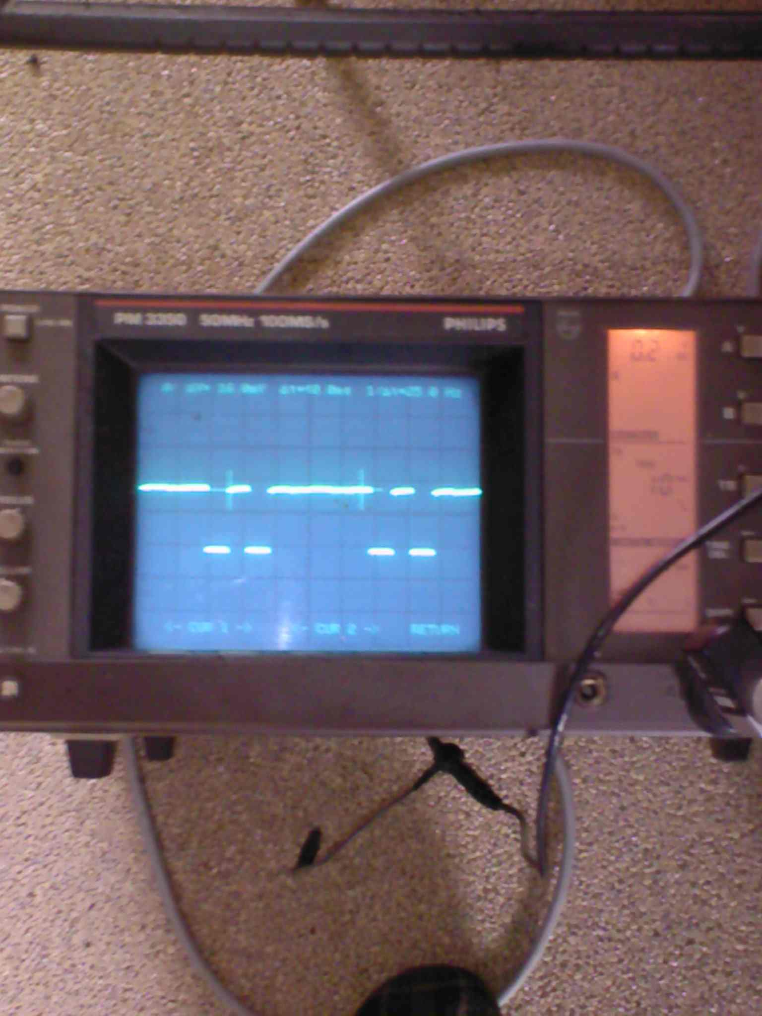

If you look at the scope plot you posted, the two pulses were independant so they both had their own timing figures. If you increased fuelling or RPM until the pulses merged (which is a really bad thing hence Jean re-writing the code to allow a transition to single pulse mode) the timing figures change, hence the third table that Paul mentioned earlier.

Dual pulse mode is the default mode and what you were seeing on the scope (I think Rod's message has a typo and that is what he meant). To set single mode, you go to the sequential injection window in the Advanced menu and set the RPM at which the code will switch from dual pulse mode to single pulse mode.

What you see on your scope (Will) is dual pulse and the default.
If you put your scope on the MS2 outputs running the JimStim you can clearly see the change from dual pulse to single and see the effect in TunerStudio too - try it with the change set at 5k RPM and you will see the injection timings change (depending on how you set the third table) and the pulse width switch from being split betwen pulse width one and pulse width two to all being on pulse width one.
