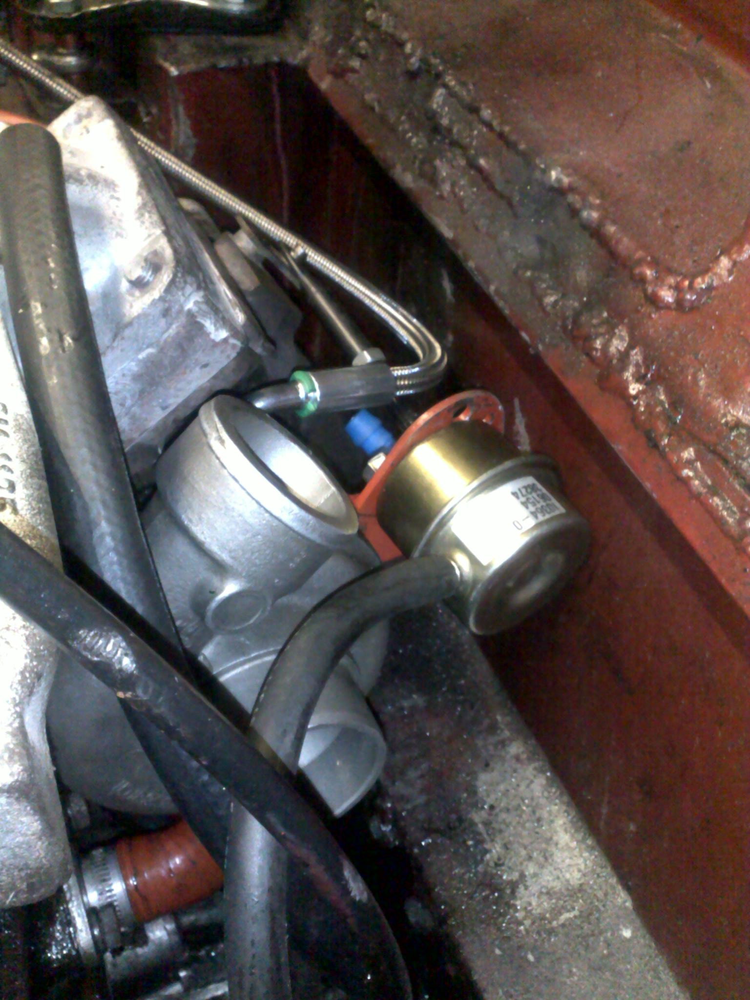

sorry to resurrect and old thread but this ties in with what im asking.
I have bought a t2 hybrid turbo and its all fitted, but ive had to temporarily set the preload to 1 1/2 holes...(cause the actuator rod isnt long enough) i drove the car home and i dare not use full throttle.. i gave it a blast on my street but i took my foot off the throttle when it got to 10psi. i found a website that sells an actuator very similar to mine and it says its standard 5psi...and im assuming that its 5psi at half a holes preload? it did take a hell of a lot to pull the rod out compared to my old t3 one. does the more effort needed to pull the rod mean its a higher boost actuator?

This is the actuator i have.

Obviously the more pre-load you add, yes the more boost it will take to operate. If indeed it actually has any travel left to operate.
Lengthen the actuating rod.

Use a foot pump or similar connected to the boost line on the actuator to pump it up a little, this will push the rod out enough to get it onto the arm.

i bought a little thinga-ma-jig to use with the footpump idea, but then i just thought, fuck it, take it all off and do it right! anyway to wrap this up, that actuator is a 9-10psi spring with HALF a hole preload... i had it at 1 and a half holes at first :S good thing i never fully belted it!!!
