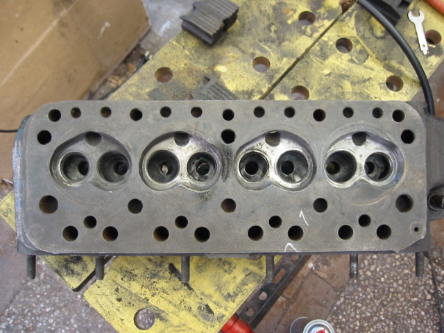

well. i have beavered away on a 202 head and with the stainless MS valves and quite a bit of effort I managed to get (at 11mm lift) 60 CFM@10 inches of water on the exhaust.
which basicly means that is flows more or less the same than a pretty decently ported st3 12G940 with a 29mm exhaust valve i have tested.
intake is yet to be finished but i suspect quite a bit of flow there as well.
all in all i think that while it is a huge amount of work, a 12g202 is a very viable option for a turbo head as you can get pretty decent flow ( probably down to the ''taller'' ssr which gives you room for creating a nice radius) and a low compression without resorting to much exotic work and keeping enough meat to keep a gasket alive..

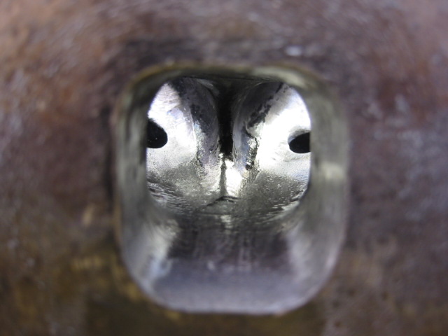

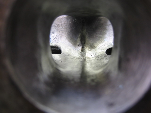

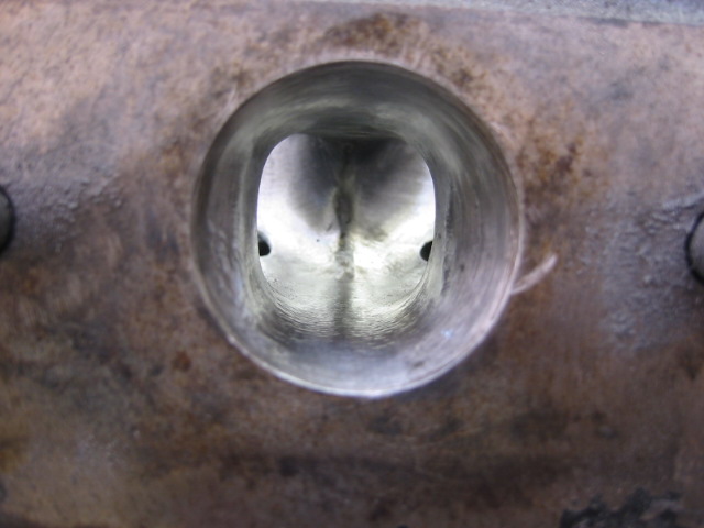

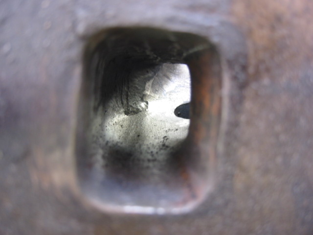

there are some more in the pic section.
It looks a lot like most other pics of worked ports but less tidy.
But there is quite a lot of subtle shape change near the SSR and the parts you can not see and have to work blindly and of course a LOT of guide boss removal. Port runners are only very slightly increased/reshaped so port speed should be nice and high.
