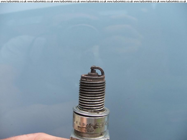

I got a little concerned when i heard a whisper that one of the engines I had built had failed drasticaly, as i was told on the grape vine*oh well* Devastated was I
The story goes, on the way back from IMM in Denmark, the engine spat its coolant out the exhaust in 500 yards, firing on only two cylinders and thoroughly cooked the engine.
The truth of it was just a head gasket failure brought on by detonation. And this is where i am let off the hook*tongue* My engine build was fine. Filling up on the continent with 92 octane unleaded, cuased the plug to overheat, melt, promote detonation and take the gasket. Oopsie, this happened in germany and it took another two days to get the car and driver home*surprised*
Bud, use tesco 99 and maybe some booster in there as well, just dont melt anything*wink*
