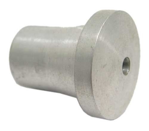

I'd say yes do it as you'll be able to take the pistons off easily, but personally i would definatly add some PTFE or ally buttons so the circlip/ gudgeon pin can't go AWOL at high RPM.
I think Will or Ben H posted some dimensions for some they made for the TT a year or so ago. I think Minispare might sell them too.

As has been said no problems doing this but fit the teflon buttons or else your just asking for a knackered bore sooner or later!!!!

If you are using the 20773 pistons I have a set of buttons to fit.
I'm now using the Mega pistons and made some new buttons up, as they are different.

does it matter what kind of aluminum you use for the buttons?
Mine are made from PTFE, there is a guide in the HOW TO section.
You can get the PTFE in 20mm bar cheap off ebay.

i've been fiddling with the buttons this eve, whats the fit into the pin meant to be like?
