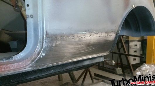

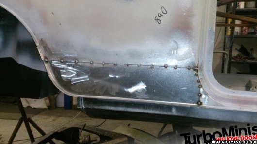

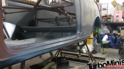

Got the step fully welded at the weekend then started on the repair to the bottom of the quarter, got it tacked in tonight.

Lookin good! Looks real neat! Is that rear pocket new?!

Yeah the pocket is new from m-machine. Was just seeing how well it fitted.

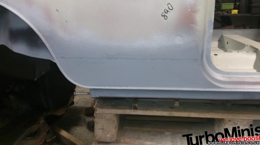

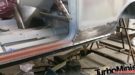

Got it fully welded tonight, very pleased with how it came out thought there might be a lot of distortion.

Good work there.
On 17th Feb, 2011 apbellamy said:
I popped my first one out the other day...
apbellamy
16540 Posts
Member #: 4241
King Gaycharger, butt plug dealer, Sheldon Cooper and a BAC but generally a niceish fella if you dont mind a northerner
Rotherham, South Yorkshire
That looks great. Have a look for some rolock disks. I use various grades to clean up the weld after going over it with a flap disk on the grinder. You can get them virtually invisible with next to no filler. Rick had to look at pictures of my car to see where I'd let some sections in when he painted it.

Cheers lads. I will get some of them ordered looks like they are just what I'm after, thanks for that. Do you use the pistol grip air tool with them? I have a die grinder but it might be a bit awkward.
apbellamy
16540 Posts
Member #: 4241
I use a battery drill. They don't need to go very fast. I just work my way down from course grit pads to scourer type pads. Comes up a treat.

Get yourself a cheap angle die grinder to use with them, you can pick one up for about £30.
Lol, very true Once it had been dipped it was hard to see old from new.
Looks like your making good progress and a good job.

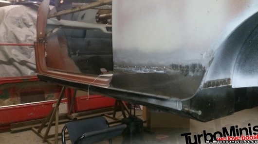

Got the other side tacked in tonight

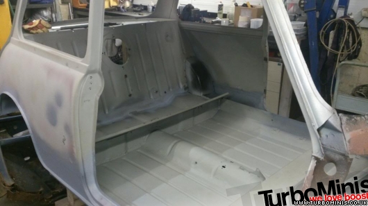

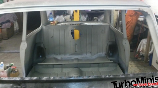

Finished welding the drivers side at the weekend, still need to linish it fully
Took it back off the spit again so I can get inside to finish welding the floor and arches, and ready for the front
bulkhead repairs. Finally got rid of the horrible bracing too

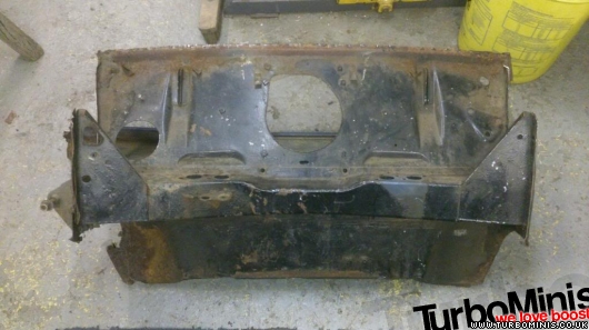

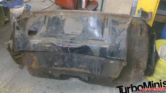

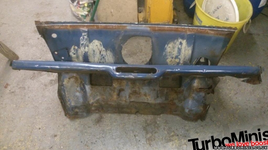

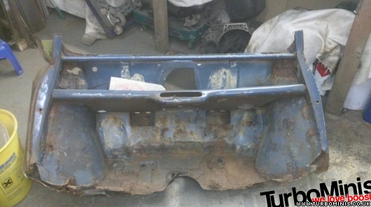

Finished spot welding the heel board to the boot floor on Saturday. Waiting for my angle die grinder to arrive before I can finish cleaning to welds at the rear so I started on the front bulkhead. There is heavy pitting on most of it so would need a lot of different patches making for it to be good again. I don't think I could make a good job of it so I'm going to replace the whole thing with another one that I have. Cutting it down to just the part I need...
Still needs a bit more work and then sand blasting, don't know if I will do it myself or pay someone else to do it,
I hate sand blasting!

Very brave!
madonminis
644 Posts
Member #: 9371
East Yorkshire
My thoughts exactly.
On 26th Feb, 2014 jonny f said:
Very brave!
BHP sells engines, but Torque wins races!
Callum
450 Posts
Member #: 10396
Advanced Member Formerly mk2turbo
Stoke-on-Trent
Brave or stupid not sure which yet *happy*
ministar
107 Posts
Member #: 10760
Derby
Brave but worth doing... Plenty of prep and measuring and it'll be fine *smiley*
Good luck and keep us updated!
