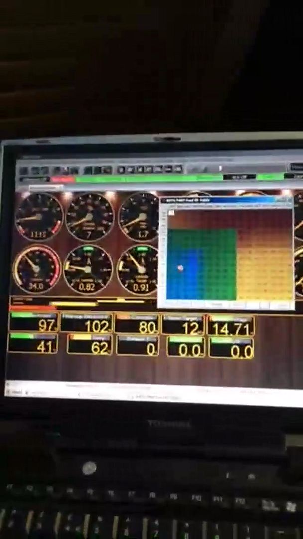

VEMS on the move, for all your data junkies and for people who like to know whats happening with your configuration whilst on move, VEMS has blue teeth :)
These are the default screens but you can customise the gauges..
All cool stuff.
