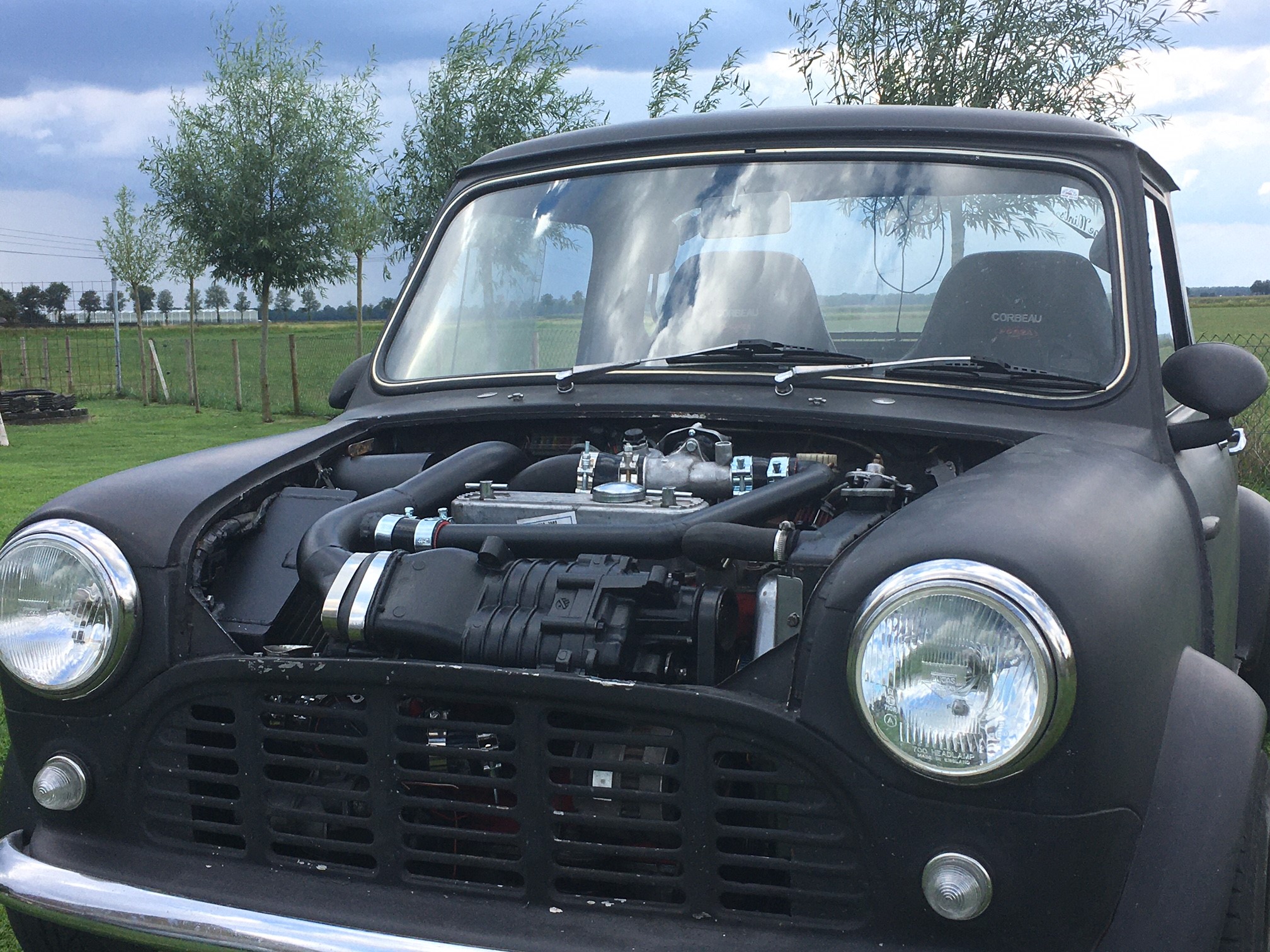

Last year I mounted a front mounted supercharger blowing throug an metro-turbo SU. That didn't work out very good. I had it running just in time to go to IMM Italy, but never made it. Problems with fuel supply.
After all the problems last year I started trying to do things right. Below my new setup:
- Front mounted Eaton supercharger
- MR2 aluminium intercooler
- Corrado G60 throttle body with build in mechanical 'dump valve' to get rid of the air at closed throttle
- Mini MPI inlet manifold with 1200cc injectors
Just got it running today, but not well yet. Have some work with Megatune first....
Will post some pictures soon
Regards,
Remko

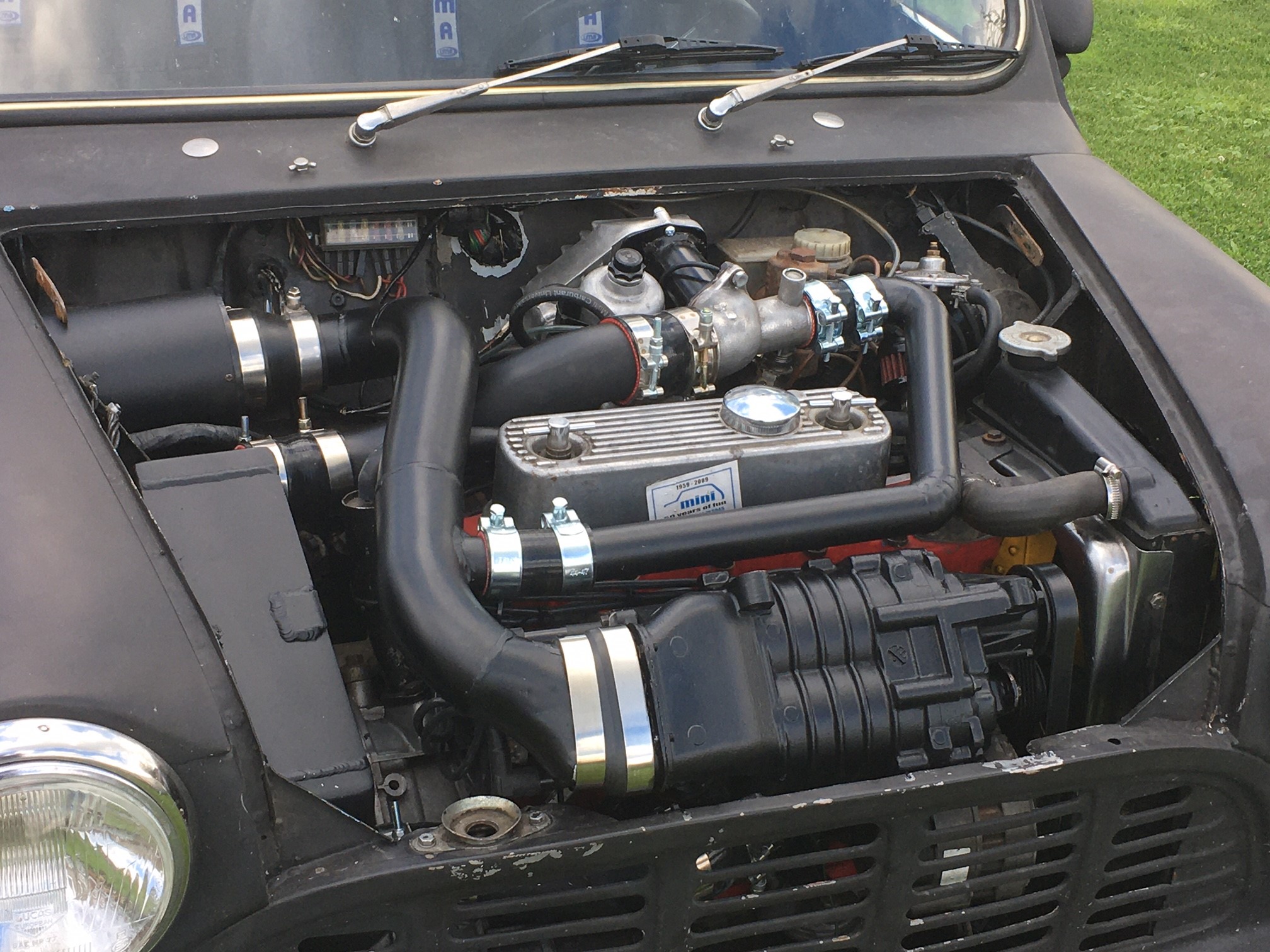

It's been a while since I updated this post. I changed the setup since last post. Removed injection, went to more retro Hiff44.
Current setup is as following:
1275 with flowed head (35.6 inlet, 29 outlet) and Kent 276 camshaft
Front mounted supercharger (0,5 bar / 7psi)
Side mounted Toyota MR2 intercooler
Volkswagen G40 recirculation valve
Blow through Hiff44
DIS coil
KDFI ECU
Finally it runs like it should! Loads of torque, perfect drivability over total range and full throttle power is great! *hehe!*

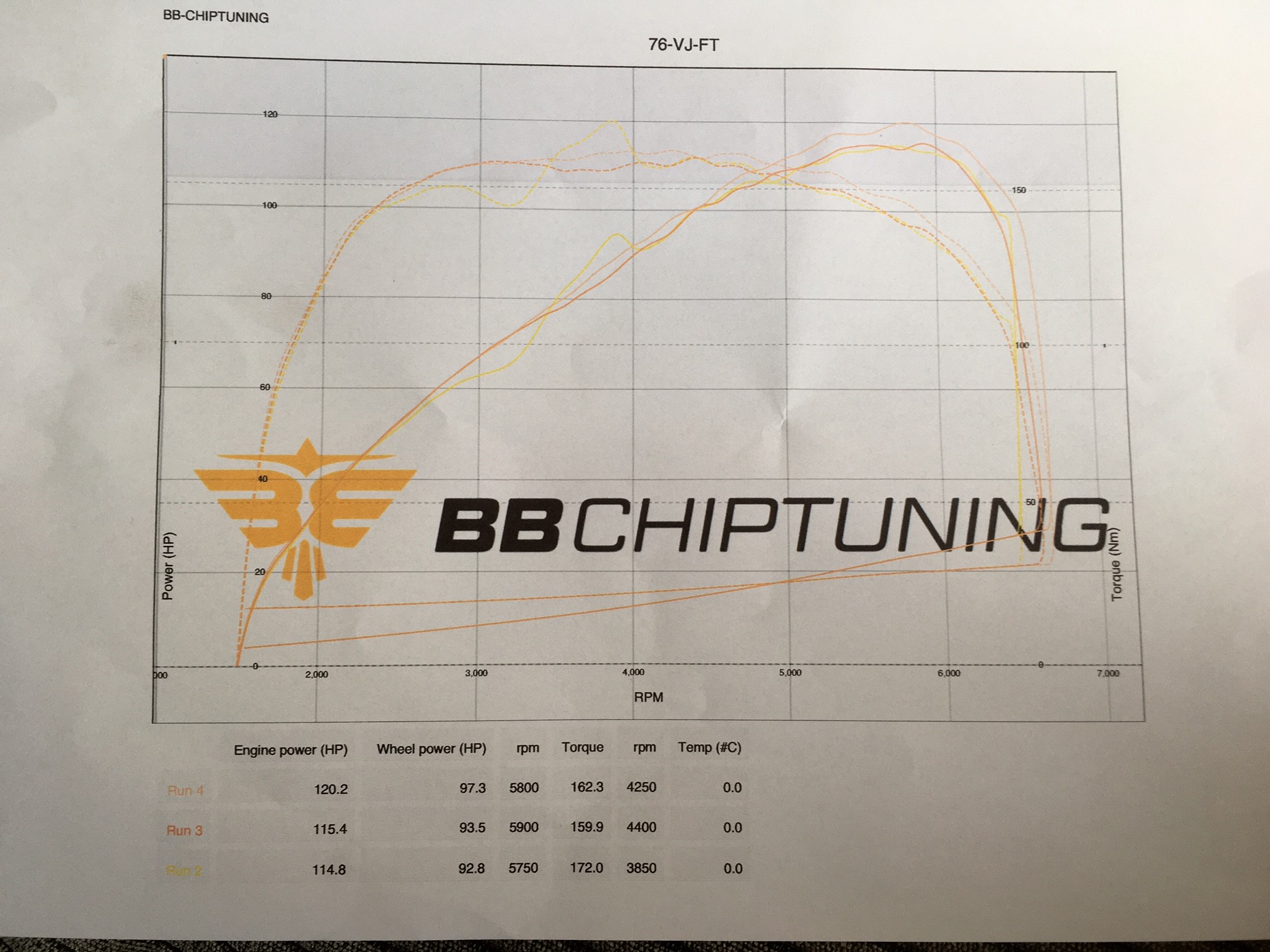

Have been on the dyno last weekend to optimize spark advance. Result: 120Bhp and 160Nm. Torque curve very flat from 2500 till 5500 Rpm. Very happy with this result!

Today I switched to a smaller pulley.
It really makes a huge difference! Now I really need to hold the wheel with 2 hands 😊
Stdandard pulley gave me 0,5 bar of boost. This one gives me a little over 0,7 bar boost!

Are you planning a trip back to the rollers? Be interesting to see the numbers now. But sounds like the butt dyno is working!
remko
75 Posts
Member #: 1956
Back to the rollers is certainly the plan. Probably only after summer during MiniProjects dyno day!
