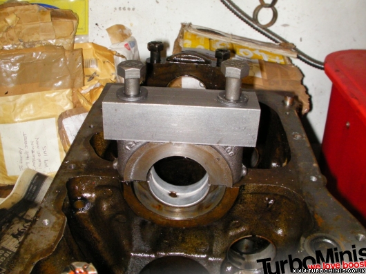

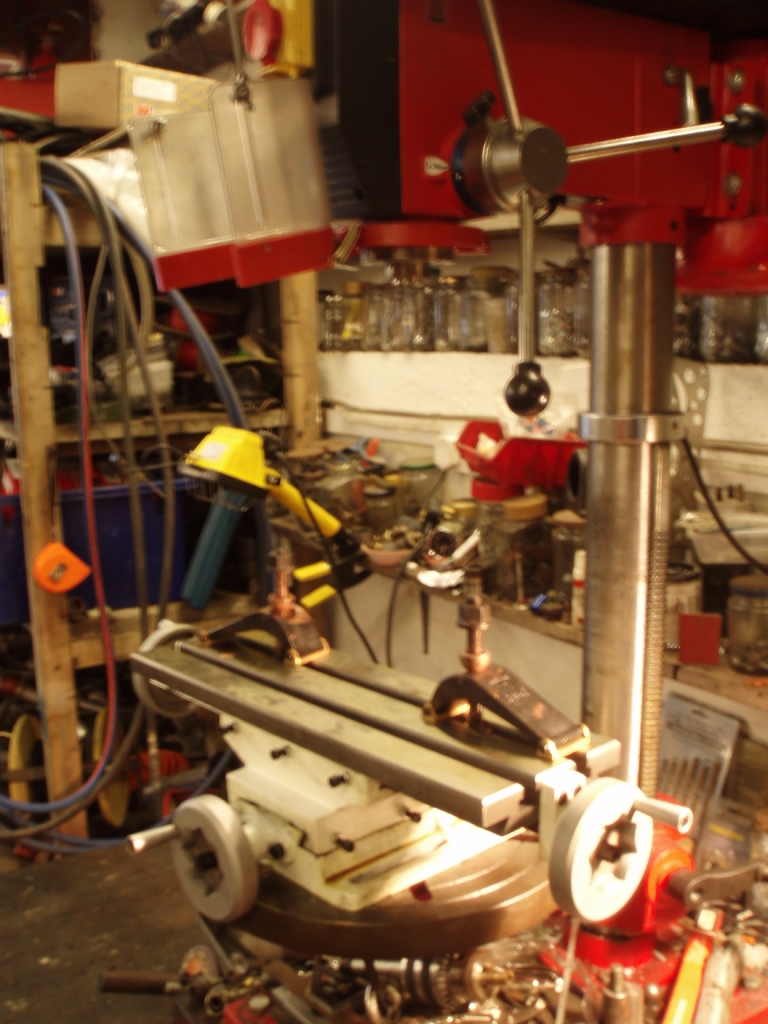

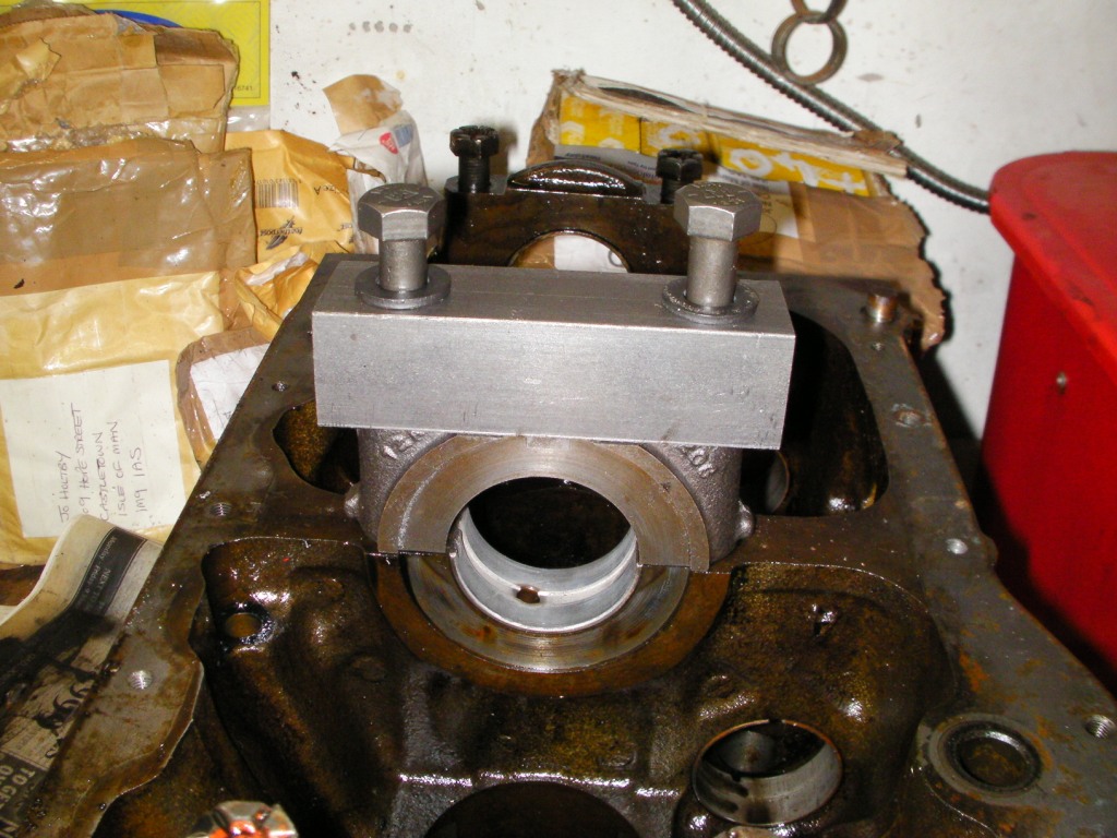

firstly i set my big pillar drill up as a milling machine to shave the centre main bearing cap flat, was a bit dubious about this, but a few people have reassured me that this is fine and it worked an absolute treat, took a video, but not sure how to upload it? anyone?
i put the cap in the vice first so only the 'hump' protruded, ground it semi flat with the angle grinder, so there was only about 1mm or so that needed cleaning up
knocked the drill down to 120rpm, and plently of wd40 and its made really light work of it, the finish wasnt brilliant but 2 mins on a whetstone and it was spot on,
end result:
do you think my strap is big enough? lol
cheers to carl for the bolts.

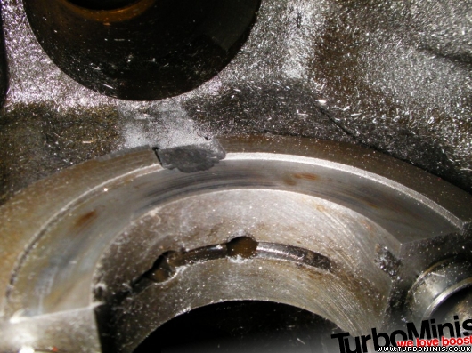

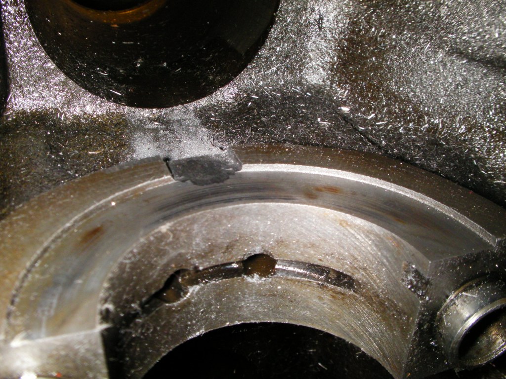

then got about modding the block so the thrust can run upside down:
so thats pretty much all the block work out of the way bar drilling the mains for undercrown cooling
i dont know what to do to the crank though (if anything?), maybe get it hardened?

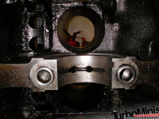

Are you sure that you need under crown cooling on the 998?
Standard 998 rods have an oil spray hole pointing in the right sort of direction.
possibly not, ive never ever seen a 998 little end!!
will have a look when i take the pots off my rods, as bat would say everyday is a school day!
The spray hole is on the big end, pointing to the underside of the piston. There is a corresponding hole in the bearing shells. It must get a good dose once a rev.
The hole can be seen here:
do all small bore roads have this? i cant believe i havent noticed it before...?

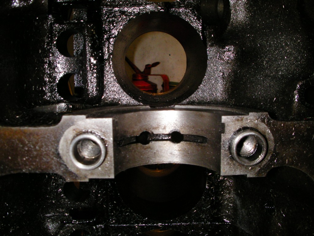

I have A's, circlipped, 3-ring slippers with this oil jet hole.
Notice lube hole in little-end is pointing up suggesting that oil hits the crown and rains down onto and into little end..?
Yes, I guess this is the reason.
