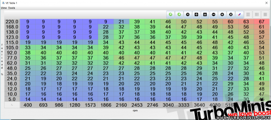

As you say you are running a MAP sensor, and the control algorithm is set to "speed density" (which is what I would expect with a MAP sensor) then "Multiply by MAP (caution)" should be set to multiply.
Edited by Rod S on 5th Jul, 2017. Schrödinger's cat - so which one am I ??? |
![]() 6549 Posts Member #: 1149 #1 Basshunter Fan Force Racing ICT Dept Manager Miglia Turbo Am frum Yokshyer tha noes! |
5th Jul, 2017 at 10:53:25am
Thanks for the Reply Rod.
On 5th Jul, 2017 Rod S said:

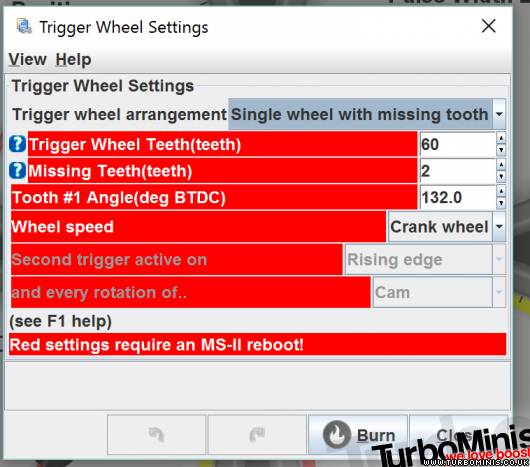

As you say you are running a MAP sensor, and the control algorithm is set to "speed density" (which is what I would expect with a MAP sensor) then "Multiply by MAP (caution)" should be set to multiply. Also your toothed wheel setting of 132 degrees is a bit strange - have you actually strobed it with a timing light, normally it should be around 60 degrees for a 4 cylinder engine. Finally, your VE table just looks strange (but I'm used to siamese code ones so I can't be sure) . Did you use the table generator in TS to create it or have you been changing it, either manually or by trying to run closed loop or something ? But the main issue is multiply my MAP should be set to multiply if you are using a speed/density algorithm, it's only set no for an Alpha/n algorithm (TPS only, no MAP). 1/4 Mile 14.3secs 96Mph Terminal 10psi of boost.
![]() 5988 Posts Member #: 2024 Formally Retired Rural Suffolk |
5th Jul, 2017 at 11:20:22am
Mike, I made a typo on the missing tooth angle, it's normally 90 (not 60 like I first said) for a four cylinder engine.
5th Jul, 2017 at 11:26:59am
Yeah, ill setup a Mark and get it strobed in. 1/4 Mile 14.3secs 96Mph Terminal 10psi of boost.

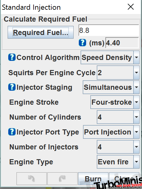

Injectors paired 1/3, 2/4 ?.................
Yep I agree with TD........ |
5th Jul, 2017 at 01:20:27pm
This also Caused me much confusion as well Colin.
On 5th Jul, 2017 Sprocket said:
Injectors paired 1/3, 2/4 ?................. I'd have thought it should be 1/4, 2/3...... same as wasted spark ignition 1/4 Mile 14.3secs 96Mph Terminal 10psi of boost.

5th Jul, 2017 at 06:09:37pm
I'd have thought 'simultaneously' would also mean all injectors together at the same time, but I found out that it doesn't always mean that.
