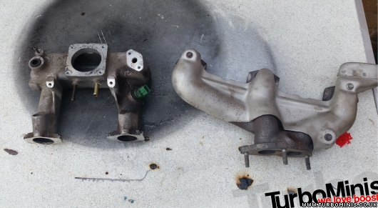

anyway parts bin raided and pulled out 3 manifolds a stock cast one and 2 injection ones that look somewhat like a turbo manifold melting and drooped to one side i picked the new old stock injection manifold out for mocking up
what i am now doing is putting the turbo over the clutch housing thus sidemounted, using the injection manifold and an extension 'up pipe' it all seems too easy,, using dual widebands settup before the turbo via sample tubes

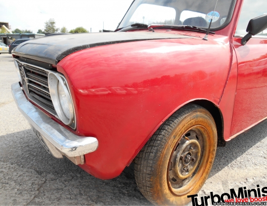

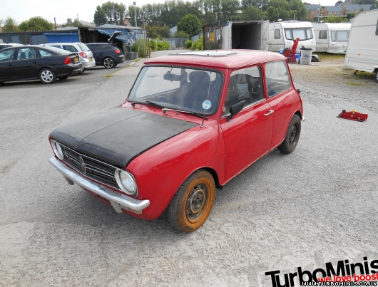

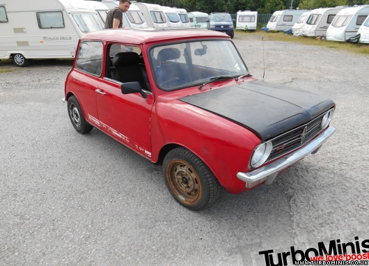

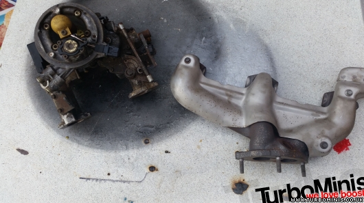

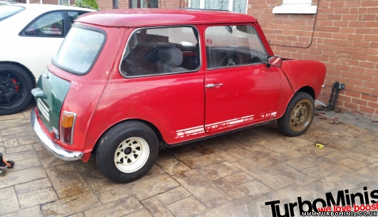

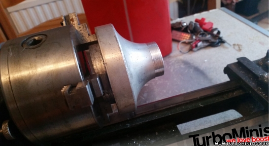

few shots of the clubby
could do with simplifying this, some stuff on there i can bin spi manifols
the bare mpi manifold here

How dare you put a picture of me in your build thread! *wink*
Please don't paint it satin black.

now, hopefully i can get all this settup with what i have to hand, the only expense i can see will be the turbo, it turns out i had a lot more stuff stashed away than i first though
cossy intercooler, the mini was already turbo so fueling lines are all there, i bought a running 998 for it the shell is rough in places but sound, the maHOOsive radiator should also just drop into the clubby *tongue*

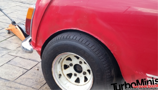

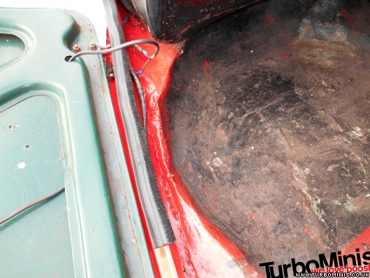

bit of movement on this now, been chasing water leaks in the shell, just the one left now in the passenger footwell, cant decide if i want to do both sills or not, there not in a bad state if you ignore the couple of patches but i have the panels already
test fitted the wellers today, i can confirm the 10x6s dont fit over the 8.4inch disk settup,
they do however fit rather well next to them lol,
they have gone on the back for now and a health height loss

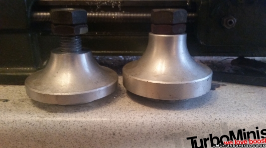

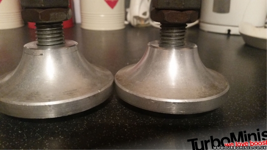

been at it again, this mini is going to be another slammed mini, why not its my thing *happy*
anyway putting to use tricks i employed on the vtec mini, i know the hi/low units dont alow it to drop enough
so today i shortened a pair by about an inch, and by my calcs thats an extra 3 inch drop at the wheels and also it should be able to sit the shell on the ground hahaha,

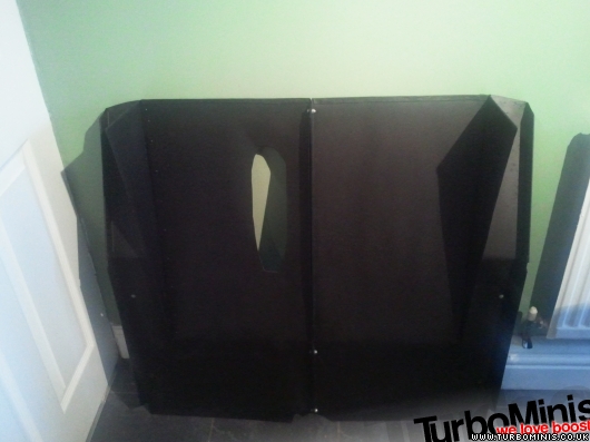

i think i will custom make shock mounts for this one, tempted to put the diffuser from the vtec mini on this too ( doesnt fit around the rear diff on the vtec lol )
