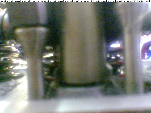

i'll have some more info on my probs with my rockers? valves? whatever this probs seems to be i gotta wip th head off?
i've just been out & had a look at the rockers & they sit level & flat when the gaps are set correct

Realy the length of the valve should not make any difference.
If you have set the clearances properly and the springs aren't binding, then the only possible explanation is that the exhaust valve is hitting the block. This can happen with high lift cams and a skimmed 12G295 as the valves do overlap the block deck, although I'm surprised that it can happen in this case.
Take the head off and measure the distance from the face of the exhaust valve to the face of the head. If this is less than the valve lift (0.320") minus the gasket thickness, then that's the problem.
EDIT: Check that you have a full thickness head i.e. minor skim only. The reason I say this is that when Morson did one of our heads a couple of years ago, we did not get back the head that we supplied.
